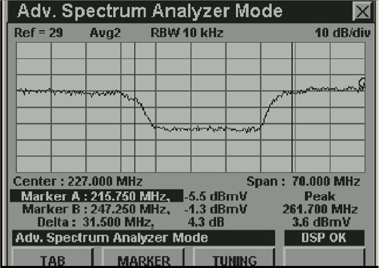

I understand that I won't be using it during normal hour, but at 2.00 AM I can use it for forward and return sweep.
It must also be done with two technicain, one person in the field and one person at the head end to turn off the unit when not in use.
Any one else use noise generator for sweepping their system.
Here is a picture of a sweep of a negative trap.
