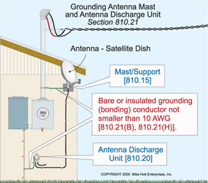

A. No. You must ground the antenna mast [810.15] and antenna discharge unit [810.20(C)] to one of the following, as shown in the Figure:
The illustration above shows how the antenna mast and antenna discharge unit must be grounded when installing a satellite dish.

Grounding the lead-in antenna cables and the mast helps prevent voltage surges caused by static discharge or nearby lightning strikes from reaching the center conductor of the lead-in coaxial cable. Nothing can prevent damage from a direct lightning strike, but grounding with proper surge protection can help reduce damage to satellite and other equipment from nearby lightning strikes.
