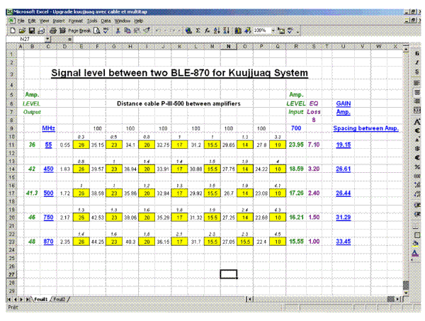

Here we go:...    They comes with 2-4 or 8 output. They comes with these value (input to spigot output) 35-32-29-26 or 27- 23-20-17-14 and 10 dB.      In a bi-directonal system the highest value you should use is a 26 or 27 dB (depending on the company that make them). Attached is an example of between 2 line extender. I usually design for a + 15 dBmV at each output.
