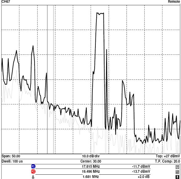

Viewing our return path on either an HP analyzer or with Pathtrak these beats(?) usually appear at a lower amplitude on the high and low sides of the data band, though sometimes (rarely) they can appear to be random impulse noise scattered across the entire spectrum.
The more typical “beats” viewed with max hold will build up “shoulders” on the sides of the data band or will form “horns” or “wings” to the left and right of the data band. (See the Pathtrak pictures I’ve included. One in this post and one in a reply.)

Even though they appear to be beats because of their amplitude being less that the primary carrier another theory is that they are not beats at all but instead are modems transmitting out of their allocated bandwidth.
Are there any CMTS experts that could answer whether that is possible? Could it be a simple matter of a modem not being told to limit its transmission to the proper frequency range? See the “wrongFrequency” shot. This seems clearly to not be a beat but a case of a modem(s) talking in the wrong place. The amplitude is only half of normal like the other “beats”. This happened immediately after a return pad was replaced and the modem(s) reestablished its upstream connection.
