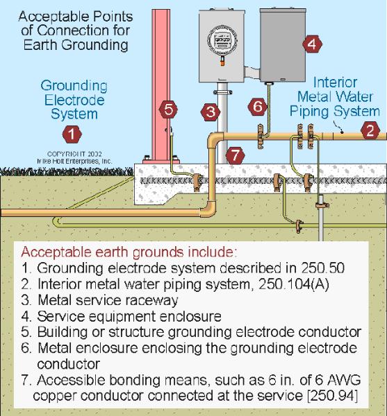

810.21(F) (1) Grounding Locations Figure 3
a. The building or structure grounding electrode system as covered in 250.50,
b. The grounded interior metal water piping system within 5 ft from the point of entrance into the building as covered in 250.52, Figure 4
c. The power service accessible means external to enclosures as covered in 250.94,
d. The metallic power service raceway,
e. The service equipment enclosure, or
f. The grounding electrode conductor or the grounding electrode conductor metal enclosures
If the grounding conductor is run in a metal raceway, then both ends of the metal raceway must be bonded to the grounding conductor [810.21(D)]. When an electrode such as a ground rod is installed to ground the mast or lead-in cable, it must be bonded with a 6 AWG copper conductor to the grounding electrode system at the building or structure served [810.21(J)].
